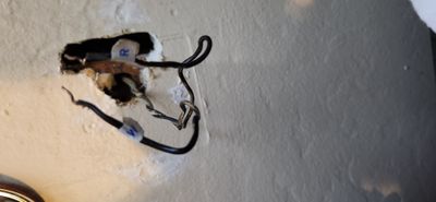

Looks like basic R to R, G to G, Y to Y, W to W
But the regular Nest usually needs a C wire to get stable voltage to keep it powered up so I would go to the furnace take off front panel and see where the C wire you mentioned is connected at the furnace screw terminals. Hook it up to C screw and then hook it up at the Nest to C.

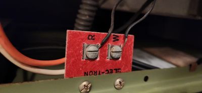

I am using this on  a gas furnace with an R and W wire.  I also have the Nest Power Connector because I do not have the C wire.  All 3 wires are connected to the right connector on the thermostat.  Using the old thermostat the heater will work. I have reset the thermostat to factory settings and re-installed it but no luck on getting it to heat the house.
Do you have a picture of the wires at the furnace to confirm you hooked up the power connector properly.
mrbing
I confirmed the R and W by testing with the multimeter on each end.
Where is the Nest power connector, the white device hooked up?
It needs to be wired to the furnace correctly I don't see it in your pics.
It needs to be connected so the 3 wires RWC go to the C screw at the furnace transformer and the R W screws on the furnace,  Then you connect the 2 wires that are on the furnace in your pic to the 2 wires on the connector R W.  Then at the Nest only the R and W get connected (you wont have a C wire at the Nest).

I have an older furnace that uses a 24volt transformer and that is where the two wires originate from and the R&W are the only two connections that go to the old thermostat.  I bypassed the Google Power connector and the heater turns now turns on.  What is the downside of not using the power connector?
There is a common side of the 24v transformer on the furnace.
You have to locate the transformer, there are 2 wires that leave the transformer, one goes directly to the little red panel "R screw" that is the + R side of the transformer, the other wire coming off the transformer will be the C - common side.
You might have to tap into the common wire with a wire nut or similar method since there is no screw for it.
Then the power device will go to the C and then remove the 2 wires from the red panel screws and put R W from power device to those screws.
Then the old thermostat wire that was on the 2 screws splice to the power connector R W wires.
