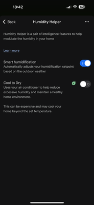

Since when?  This was the main reason I bought it. If you can point me to some official web page from Nest saying that please do. There is an actual setting where you turn it on or off. It's called Humidity Helper. Doesn't work, but it's there.

I wanted to make a correction on something I said in the above post. I stated that the Humidity Helper didn't work. I found it does. If it is actually turning off your humidifier because your humidity setting is too high, it flashes that info on the app saying "humidifier off to reduce condensation moisture", It does NOT tell you where it's set at,  Just that it is off. The settings you made for the humidity level in the app stay the same.  That's why I thought it wasn't running. I thought it would reflect the target level in the app. If your not running a schedule on your thermostat, no humidifier information shows on the app. I made a 24hr default schedule with my most common setting and adjust from there realizing it will reset the next day. But at least now I know if it is working and the humidifier is running.

great find! badly made app it seems then.. nothing is clear on it anyway

When the Humidity Helper is enabled and active, you should see the following on the Google Home App:
Below the temperature it will say: Humidity Helper and below that, a water droplet with a small + on the right.
Below the temperature dial indicator it will say:
Lowering target humidity to reduce condensation.
Mine is set at 40% but our temps are near zero so it has not been turning on the humidifier, and thusly, humidity has been decreasing with each heat cycle. They have also done an update that now allows access to Advanced Settings, for the humidifier and other equipment.

This must be all new. I saw it on mine today too for the first time. It would be good if they indicate what % the humidity helper is "targetting"
