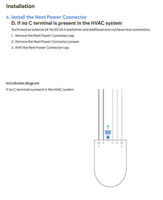

Here is a suggested way to wire the power connector to your system when you only have 2-wires and no C terminal at the furnace. Let me know if you do have a C terminal at the furnace and I'll provide a different wiring.
I appreciate you sharing the diagram, @Patrick_Caezza. It's a big help!
