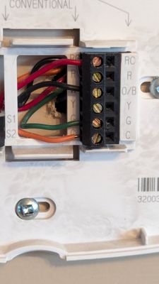

In the summer, I replaced an old Honeywell thermostat with a Nest learning thermostat on a basic furnace. Everything was working fine in the summer (blowing cold air),but now that winter is approaching the thermostats is still blowing cold air on the heat settings.

sdoyle80
Hi Douglas, I have a Trane XR90 Furnace.
I have attached photos of my original thermostat wiring, new wiring , and specs of my new thermostat.
Thanks for your help.

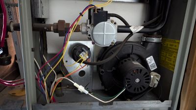

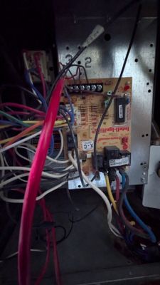

sdoyle80
Hi Douglas, I have attached some photos of the inside of my furnace. Are these the photos you need?
SoriaD_
Hello @sdoyle80
Thanks again for all the details you provided me, I really appreciate it.
My team and I have been checking the images with the instruction manual for your Trane XR90 Furnace to which we have seen some inconsistencies in the wiring for the thermostat to perform this function. According to your manual, to perform this action there should normally be a cable connected to the "Y" port coming from the outdoor unit.
That said, for your safety and to be completely sure, we recommend that you contact a specialized technician to determine the solution to this situation and make the necessary changes to your unit so as not to have any problems.
Feel free to keep us posting, we re happy to help you.
Douglas.
