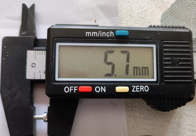

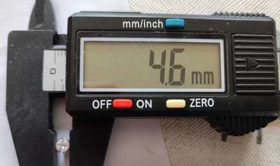

I posted previously on this topic but the thread has been closed so I cant provide an update.  I lost one of the T1/T2 terminal screws on my 3rd gen Wireless base unit as per photo below and a kind community member responded with a potential screw size but it wasn't quite right (their screw length was over 13mm whereas mine is much shorter).  I've now measured with my calipers and I wanted to provide the actual screw size dimensions and update on my progress with regards to finding a replacement.

Photos of the screw measurements in mm are as follows:
Length without head (shaft length) 4.2mm
Total Length 5.7mm
Shaft diameter 2.3mm
Head diameter 4.6mm
So to summarise:
Total length: 5.7mm
Shaft length: 4.2mm
Shaft diameter: 2.3mm
Head Width: 4.6mm

I instead headed over to ebay and bought the following M2.5 4mm machine screws for 99p (link below).  The dimensions don't match exactly but they were the closest I could find.  They are due to arrive by Friday and at less than a quid I thought they were worth a shot.

Morning All!
So the m2.5 X 4mm machine screws arrived on Thursday as scheduled. I have just tried one in the nest base plate terminals and it fits perfectly. Screws in just like the original. So there we have it folks, if you lose one of your T1 or T2 terminal screws you now have the size: m2.5 X 4mm.  Thanks all.
