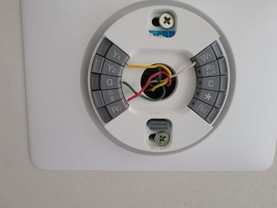

Hello all at 1st I was getting only hot air on cool. I switched some wires, and the heat pump setting now I am getting air but it is not cold. any ideas what could be the issue ?

I could not find the Picture with my older thermostat setup, before the wires were removed But I did keep the old unit as I made the change some time last year Fall.
I did get in contact with a Nest Support Agent, and I was told it might be an issue with my Yellow wire, I am working on getting that looked at as soon a possible.
But before I do, I realized on my old Thermostat the RH and RC looks like there were connected together with the black wire bridged, would doing the same on the Nest possibly be my solution ?

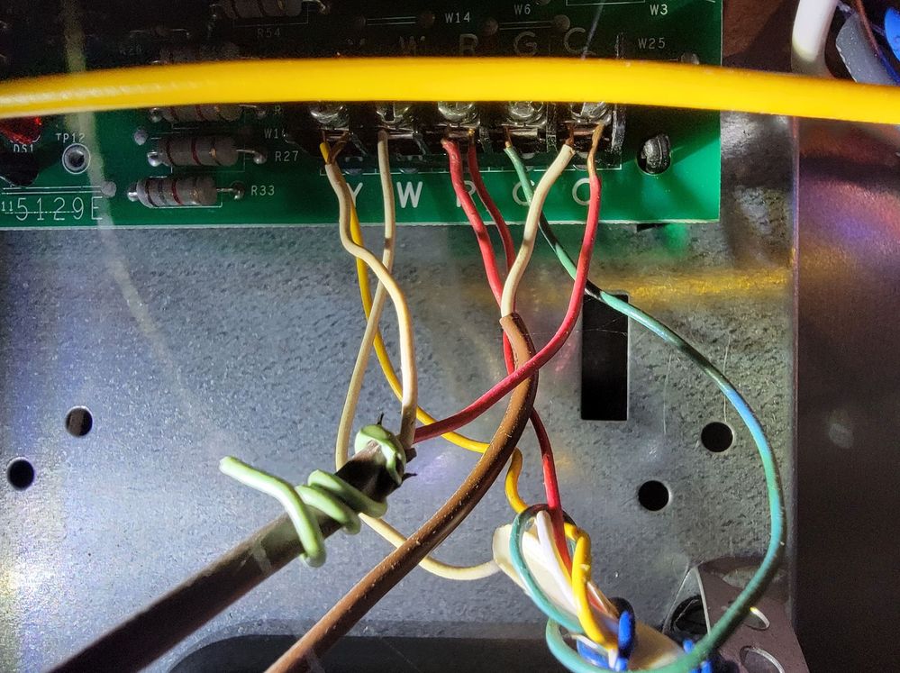

Take a look at the terminal block on the control board in the furnace/air handler and post a picture of it here.
Good Day all here is the a picture of the control Board in the handler.Air Handler Picture 6-8-22.jpg
You have a conventional system and not a heat pump.
Your wiring looks correct going by that picture.
Do you have a Humidifier installed?
I see a spare blue wire, you should connect that to the C terminal and then the C terminal on the thermostat. Then do a reset to factory defaults and set it up again.

I do have a Humidifier, I tried as you suggested and got the blue wire connected and on the Handler and Thermostat and reset the Thermostat to Default but now I am not detecting the Heat, only Fan and Cool, and I am still getting Warm air on cool and the Blue C wire is being detected.
Also while looking I found a Pic of the Old thermostat, connections, I will try to reinstall the old Tstat to see if I may have an issue else where today after work.Blue C Wire ConnectedBlue C Wire ConnectedOld Tstat connectedOld Tstat connected
