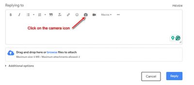

@Patrick_Caezza @Thanks for your reply. I do have a photo of the old layout but not one of the new. I am new to this forum and can’t seem to find the option to add a photo. I am using an iPad. Any suggestions on uploading photos.
Thx
@DIY_Bob
You can upload a picture this way.
@Patrick_Caezza Thanks. That wasn’t available the first time I responded.  Here it is. I don’t have a pic of the wiring I did for Nest unfortunately.
