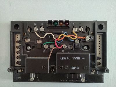

My old thermostat is a Comfortmaker brand Q674L 1538 from what I can tell. I can not find a diagram to confirm what the X terminal is on this system. Almost ever part is identical to the Honeywell Q674L thermostats except the terminals are different. On the Honeywell the X terminal is the same as the nest W2/AUX.  I'm trying to determine if I can use this and what thermal on the nest to use. Any help is appreciated.

I would suggest wiring it like this.
White - W1 to W2
Black - C to C
Yellow - Y to Y1
Orange - O to O/B
Blue - X to * (set as emergency heat)
Red - R to Rc
Green - G to G
Could you explain the W1 to W2 change? On the help line they had me keeping it in W1. With a quick Google search I understood the comments about the X terminal. Thank you for that.
