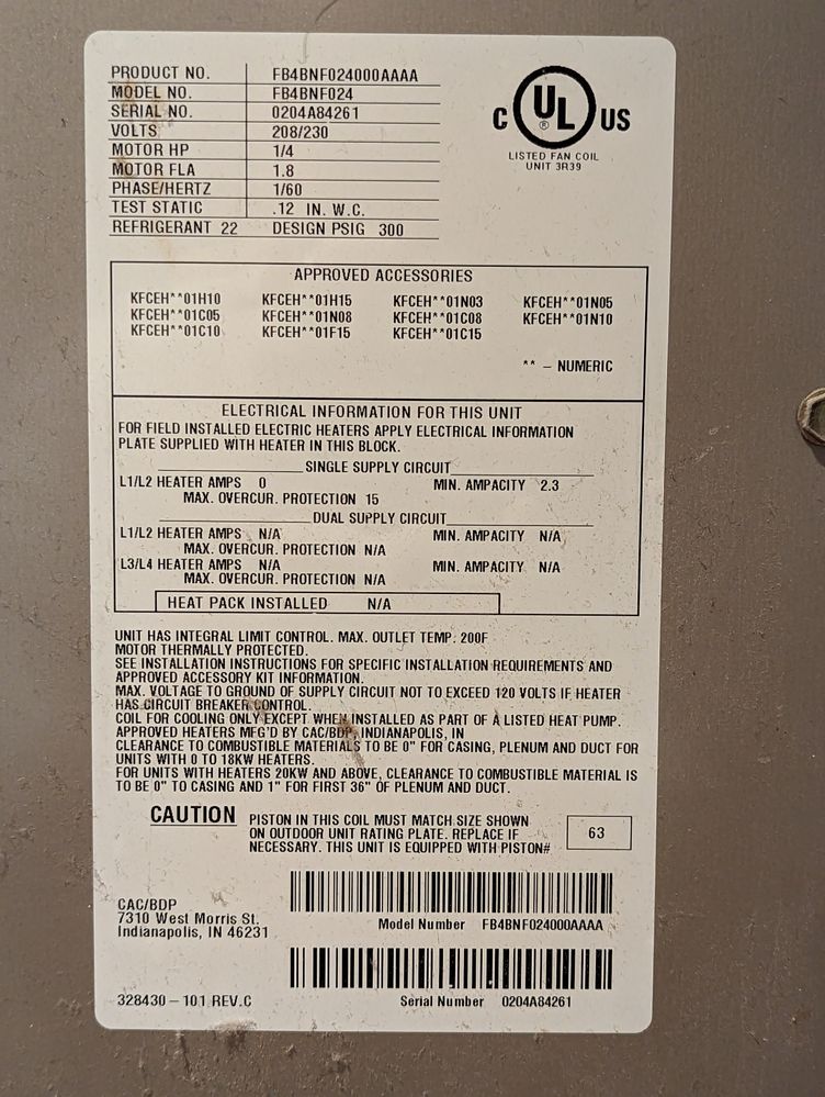

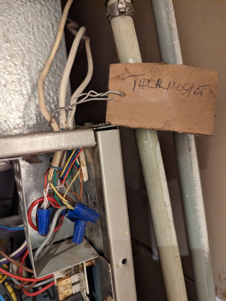

Thanks Mel.  Here are photos/info for the air handler that I can reach without a ladder.  Let's start with that one.  What do you think?  Do you need me to trace a wire?? sorry about the photo
2nd floor wiring2nd floor wiringCarrier model  FB4BNF024Carrier model FB4BNF024Wiring, as it enters the air handler - one cable labeled  'thermostat'Wiring, as it enters the air handler - one cable labeled 'thermostat'sideview of wiring box - focus on textsideview of wiring box - focus on textsideview of wiring box - pulled backsideview of wiring box - pulled back
