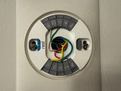

  • Can you please send me a picture of the thermostat wiring?
Any additional details you can provide will be helpful.

We need to isolate the issue to identify if the issue is with the backplate of your Nest Thermostat; for this I recommend the steps below:
  • Check the power readouts in Technical Info
    • Battery
    • Voc
    • Vin
    • Lin
  • Swap the other Nest Learning Thermostat display.
    • Check if this thermostat has the same problem, switch to cool, and turn on the AC.
If the issue continues, please continue to this step.
  • Turn off the power to the HVAC system.
  • Swap the W1 wire to the Y1 terminal.
  • Turn the power back on at the breaker box.
  • Switch to cool mode but expect heat.
Check if the system runs. Some systems take time to start up so allow 5 minutes for the heat to turn on.
Let me know how it goes.
