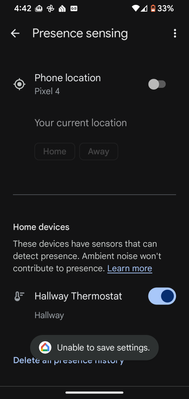

Hello Humberto,
Here is the information you requested:
What type of Nest devices do you have?
  • Two (2) Nest Gen 3 Thermostats in one home group. Phone presence NOT being used.
  • One (1) Nest Gen 4 Thermostats in a different home group. Phone presence being used.
What is the error message you received with the Presence Sensing?
  • I get "Unable to save settings" message in Google Home when attempting to enable presence sensing for the Nest Gen 4 device.
  • Presence setting does not get set and remains OFF.
  • Reference the screen grab below which I have annotated to highlight the user action (#1) and the response from Google Home (#2).
What apps are you using to control your Nest devices?
  • The Nest Gen 4 device is only controlled by Google Home
  • The Nest Gen 3 devices are controlled by both Google Home and the Nest app.
Please note: I have already tried deleting the home from Google Home. Factory reset the Nest Gen 4 thermostat. Cleared Google Home app cache and memory. Recreated the home and added the Nest Gen 4 thermostat. After all that I still get the same "Unable to save settings." error. I have disabled phone presence sensing and still get the error trying to enable Nest Gen 4 device presence sensors.
Please also note: All other settings on the Nest Gen 4 device are working well. The ONLY issue is enabling the home device presence sensor in the Nest Gen 4.
Regards
humbertogarcia
Hi @Leviosa
It's great to hear from you again, and thanks for sharing that screenshot - it really helps clarify things. I've got a much better handle on what's happening now.
Here's the key thing to keep in mind about location sharing for your phone:
If you're currently using the Nest app to share your phone's location for Home/Away Assist, allowing location sharing in the Google Home app will actually turn it off in the Nest app. Your phone's location-sharing feature is limited to just one app at a time.
Hope this makes sense. Feel free to ask if anything else comes up; I'm happy to help.
Humberto
Humberto, let me be perfectly clear on this point.
-> I am NOT USING phone location for home/away assist!
-> I have turned off using phone location on both apps.
-> I do not want to use phone location at all.
I ONLY want to use the built-in sensors of the Nest thermostat to detect presence.
To illustrate this point, here is a screen grab from the phone that shows the error happening.
Please note that phone location sensing is OFF.
Google Home throws an error when I try to enable the built-in Nest Thermostat presence sensors.
Please let me know what additional information needed to help debug this issue.
Thank you

Leviosa
It appears this was a widespread issue. Thanks to community members who raised this issue here as well as through contacting support, Google has fixed the issue. It appears to be a Google Nest server-side issue (in the cloud) and nothing wrong with our thermostats or how they have been installed or configured.  Magically overnight I am now able to toggle the presence sensing. With the parameter being saved without error.
The problem is resolved for me at and others reporting the issue also fixed for them. See thread: Re: Presence sensing error message "Request contai... - Google Nest Community
