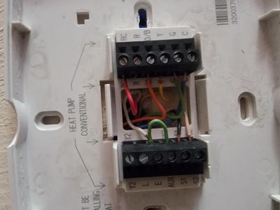

I have a dual fuel system. Current thermostat has 8 wires, Two of the wires are S1 and S2. Nest doesn't use these wires. Do I simply tape these. I have seen some diagrams that show the pink wire going in Y2 and the black wire going to the *.

05-01-2022 08:08 PM
The S1 and S2 wires are from an external temperature sensor, and none of the Nest use it. Just tape them off.
Please post a picture of your original thermostat's wiring, and I will try to provide a wiring list.
05-01-2022 08:49 PM
Current Wiring
05-01-2022 09:13 PM
Give this a try.
White - E to W2/AUX (jumper to AUX not needed)
Black - S1 - not used
White - S2 - not used
Red - RC to Rc (jumper to RH not needed)
Orange - O/B to OB
Yellow - Y to Y1
Gren - G to G
Blue - C to C
05-02-2022 06:56 AM
Thanks for your help. I have seen several suggested configurations. Most agree with yours with one exception. The white is showing going to W1. Could this be because I have dual fuel and not auxiliary heat?
05-02-2022 09:00 PM
You have a heat pump system and the yellow (Y) wire is what changes it between heating and cooling.
The white wire is for AUX heating and that is done on the W2/AUX terminal. You can use the W1 if you want, but the correct wiring is on the W2/AUX and why it is labeled as AUX
