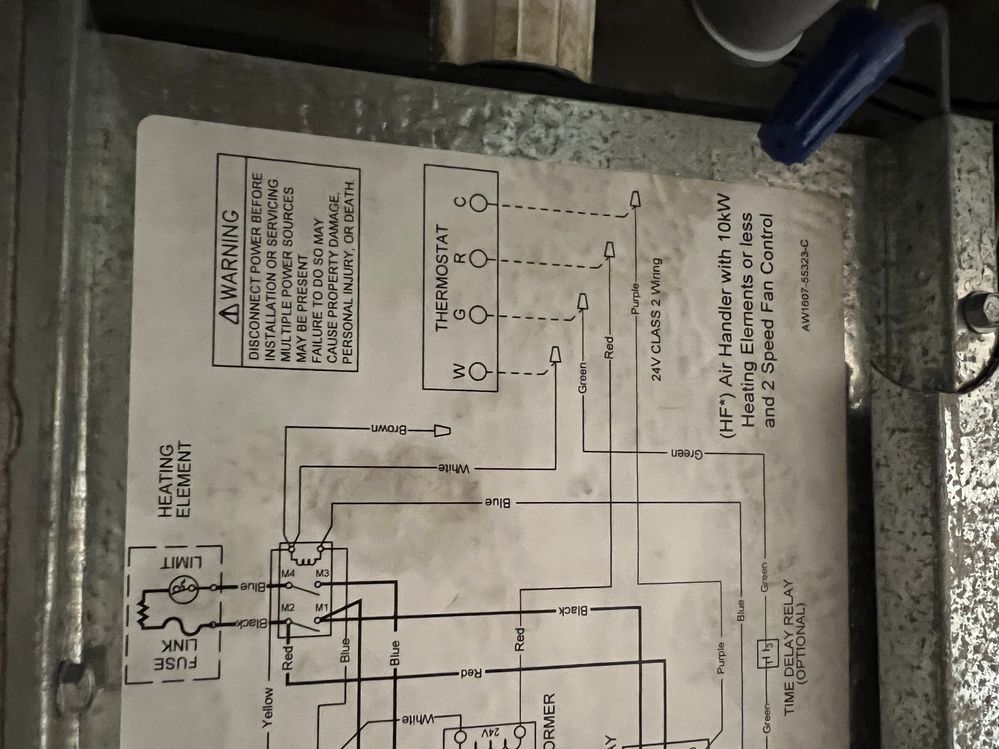

As you mentioned completing the tests I requested, would it be possible to share a picture of your current wiring configuration? I'd appreciate knowing your current wiring configuration and, if possible, a picture of the wiring that comes directly from your system. This would help me understand the reason your thermostat lost the cooling option.

Hello Angel,
Thanks for getting back to me. Let me paint the picture:
I leave in a condo that has an air handler unit in the ceiling in my unit and a condenser on the roof. Unit was installed at the end of 2019 and has always been wired the same way.
The thermostat wire connecting the equipment to the thermostat only has 4 wires, as you can see in the pictures the unit label has the same for wires connecting to the thermostat. White, Green, Red, and Purple (which is actually Blue)
The Air handler has two power wires coming out of it, one goes to the Red wire on the Air handler motor, and the other goes to the Red wire on the thermostat.
There is a wire coming from the roof top condenser that has 4 wires in it, White, Green, Yellow, and Red.
The Red wire is connected to the Blue on the thermostat.
The White is connected to the Purple on the Air handler motor.
The other two wires were cut short and have never been connected.
I hope this helps you and thank you again for your time!
aperezdeleon
Hi there Rubacu,
Whether your thermostat can control cooling depends entirely on the wires it detects. These wires will be different depending on what system your thermostat is connected to.
With your current wire configuration, your Nest thermostat should detect a conventional forced air system. Since you don't have a Y1 wire attached to the baseplate, your thermostat can't have a cooling mode, as the Y1 wire is used for cooling activation.
Your system might work with cooling if it were a heat pump. However, looking at the wiring diagram, your unit is a conventional system, so you'll need to get a Y1 wire out of your AC.
I suggest getting in touch with one of our recommended technicians to check if installing a Y1 wire is possible since you've told me your system is capable of cooling.
