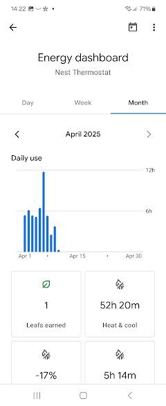

GBCheval
Hello, Thank you for the follow-up and instructions.
The photos and screenshots are added. The wiring status in the photo is grayed out (last night around 11:30pm), this morning shows all blue.
There is no box next to the HVAC or Power meter. I also spoke with TECO and there is no energy program tied to my account. I looked at Rush Hour Rewards and there does not seem to be any link.
