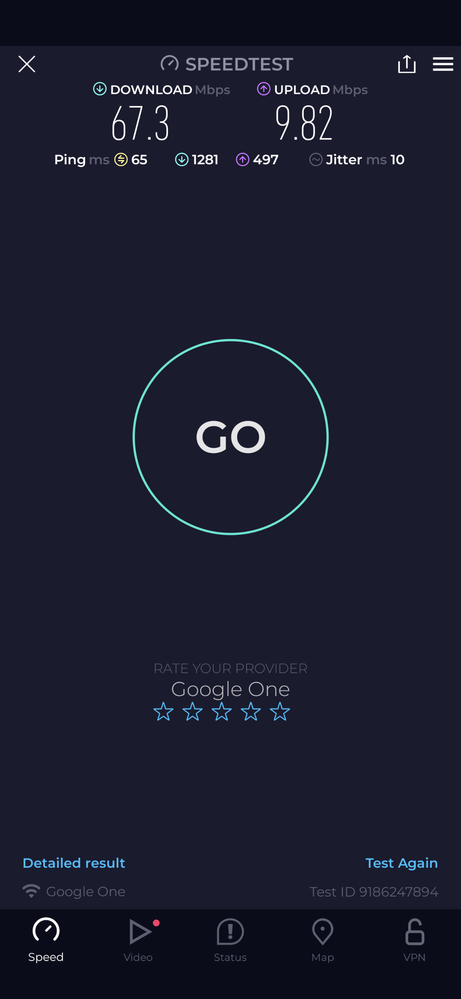

And here is why you should NOT purchase Google hardwareIncoming at modem
Via Google Mesh

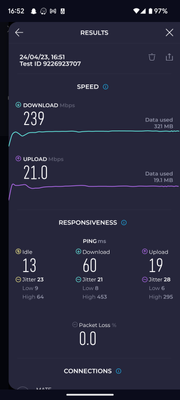

04-28-2023 03:25 PM
TP-link mesh:
Below is the Google Mesh speed.
04-29-2023 08:00 PM
Wow, it truly is shocking how bad these devices are!
