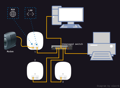

Yes it's possible. It's known as wired backhaul. Just don't try to mix Nest Wifi with Nest Wifi Pro, as Pro is not backwards compatible. And make sure to get an unmanaged switch without loop detection (STP).
Here's a diagram that shows how to wire it all up:
Here are some related guides on adding a switch and wired backhaul. Make sure to read what they say about the requirements for the switch:
