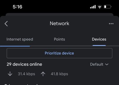

I have 500mbps speed from my ISP and I replaced ISP given router with google nest mesh for better speeds in my house which turned out into nightmare to me.
 look at 30kbps for all the devices in combine. This is what my mesh Wi-Fi system giving me. I tried calling google nest customer care and tried changing dns settings and resetting points and routers and I am back to same issue.
I did all restarts and resets and had multiple calls with support and my mesh connection looks great.
Any ideas on how to improve this???
couple more images
my ISP speed:
 My ISP speed vs what I am getting
And my mesh Wi-Fi status
