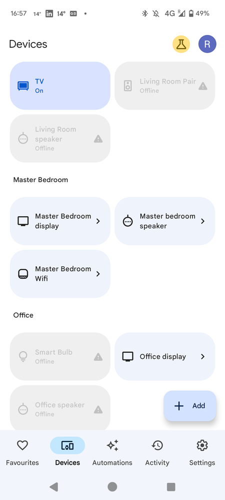

I'm having a rather annoying issue with my Nest Wifi router, and I'm hoping someone here might have some guidance. It appears that despite displaying a strong connection to the Nest Wifi point, I am unable to actually connect to the router.
As you can see from the attached images, only some of the devices are currently disconnected, but if I dare to 'Test mesh', the test fails and all devices lose connectivity. This has been particularly exasperating as it usually results in me needing to re-add every single device and perform factory resets - a process that has eaten up a great deal of my time. In the past 10 days alone, I've had to do this three times and, to be frank, I'm just not willing to go through this cycle again if the outcome remains the same.

Screenshot_20230704-165715.pngScreenshot_20230704-165741.pngScreenshot_20230704-165729.pngScreenshot_20230704-165703.pngScreenshot_20230704-171650.png
