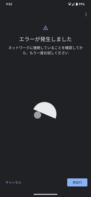

However, Google Home App did not finish commissioning normally, I got an error.

PSoC6 outputs log "CHIP:IN: Clearing BLE pending packets.", then Google Home App shows error.
I guess Matter cluster cannot join the Fabric network after Matter cluster's BLE stopped.
Error prevalence is always.
