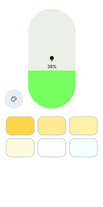

We are currently experiencing an issue with color state feedback. Our application has been successfully linked to Google Home. After we modify the color of the device through our app, we notice that Google Home does not update the color in real-time.
Specifically, when we are on the device control page in the Google Home app, the color does not reflect the updated value. Only after we exit the control page, return to the device list, and then re-enter the control page, does the updated color appear.

Screenshot of the control page:

Thanks for sharing the issue with color state update. Can you please open an issue tracker (Public Trackers > Smart Home) and share the bug ID here. Provide all the details from above along with the video from the device. I will forward it to internal teams for further investigation.
