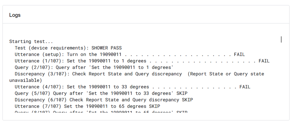

When I connect to the voice app through the Google Home of my smartphone, everything works fine, I can login in the selected voice app, see the devices listed and call the intents and see the request logged in the hosted machine. But when trying to pass the test suite from the account that has the project registered, I don't even get the requests in my server.
In Google my activity, I can see the petitions from the assistant being made, but I see in the details of the log the next errors being repeated through all the commands.
- Sorry, I couldn't reach the [project name]
- Sorry, it looks like the [project name] is unavailable right now.

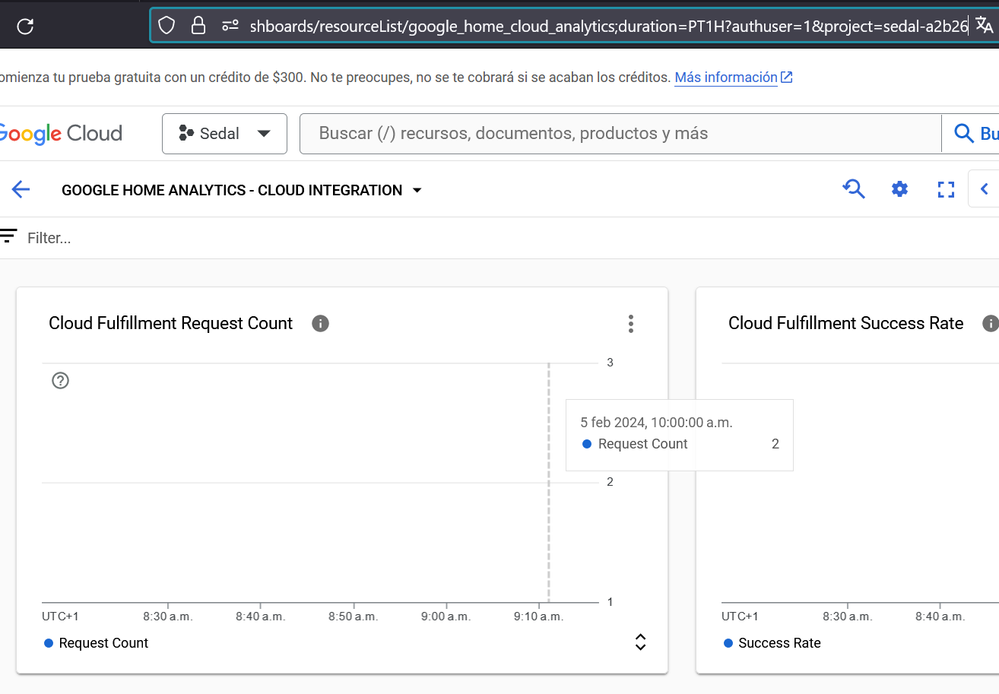

And in the Google Home Analytics - Cloud Integration dashboard, It doesn't even register the requests.

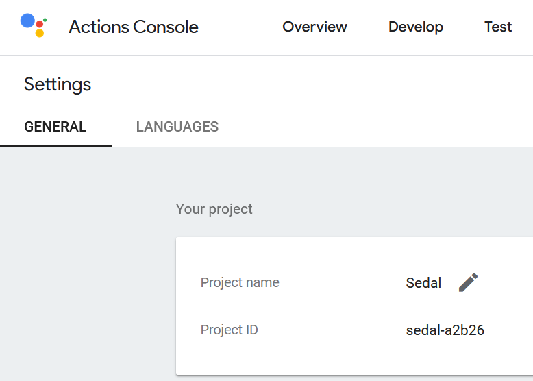

Thanks for bringing this up. Are you selecting the correct project ID when signing in on test suite website?
Can you please share the screenshots of the following: signing in on test suite website, running test suite.

Thank you for landing a hand, I attach the screenshots below. I've cancelled the test before finishing because, unless the request of device requirements, the rest of the tests fail.
projectid.pnglogstrstsuite.pnglogscloudhomeanalytics.pnglogsasistance.pngloginsedal.png
