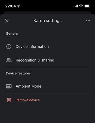

For the technical support team, I would like to add this img:
This is my google TV (Sony), in the device feature section, doesn’t  appear “audio” option:

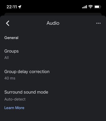

In Chromecast, you can see “audio” option for the Device Feature section. I think that, this is the problem, because inside “audio option” is group configuration:

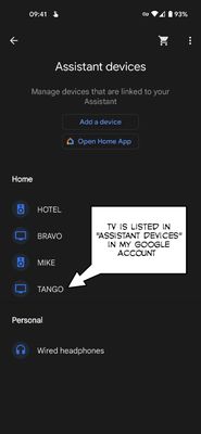

PhilipTD
@Jeran
Please find attached information which may be helpful
Thanks very much

Jeran
Awesome, thank you for posting that! I'll pass this up to the engineering team to take a look at.
