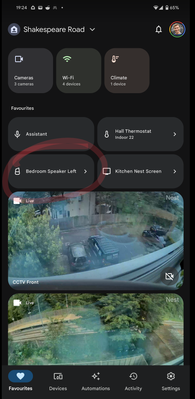

I also have the naming bug for the stereo speakers, the device list names them by one speaker (in my case the left speaker) and yet clicking nonb this opens the stereo pair
This is what i do:
- Configure LEFT device name (Google Speaker L)
- Configure RIGHT device name (Google Speaker R)
- Configure every aspect of BOTH speakers to be the same (even automatic updates), because the configuration of the STERO PAIR is NOT HONORING each device configuration (ex: if you forget to configure the ULTRASOUND SENSING on BOTH speakers - ON or OFF - configuring it after the PAIR as been created DOES NOT WORK! The device will honor it's individual configurations, NOT the STEREO SPEAKER CONFIGURATION!!!)
- Create the STEREO PAIR (that is seen on the network, and even in the Google Home App CONFIG option as the LEFT SPEAKER NAME)
- EDIT the name of the STEREO SPEAKER PAIR (that, internally, reconfigures the LEFT DEVICE NAME!!!)
STERO PAIRING has many problems...
