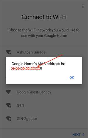

  • Do you enable MAC address filtering on your router?
You can add a MAC address to your router to allow your iiNet network to find the device. Here are the steps to find the MAC address from your Google Nest Audio:
  1. From the Connect to Wi-Fi screen, tap the More menu (three vertical dots), located in the top right corner.
  2. Tap Show MAC Address.
If you don´t know how to add it, please contact your ISP for further assistance.

The MAC address is a suggestion to verify if it is blocked from your router, since it is the only device that isn't working with your router. Please try to add it and check if it works.
