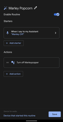

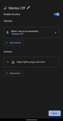

Haha, you definitely found a strange problem here. Maybe you could use a routine with a custom 'Try your own action' command for your situation as a workaround?
See screenshot below...
I just tested this with one of my lights instead of the Manleypopper command and it seemed to work ok.

Is it possible for you to change the device name to something without the name 'Manley' included and then make two different routines for on/off either like the one in my screenshot above or using the 'Adjust home devices' action.
Hopefully this will allow to say "Hey Google, Manley On or Off" but have the routine turn on/off the device without the name'Manley'.
