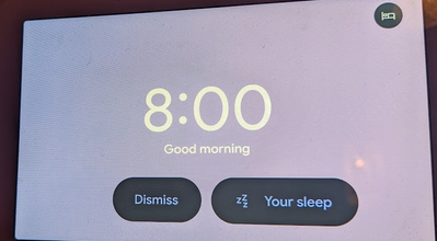

After the alarm goes off, and I dismiss it - the screen shows as below:image.png
If I "dismiss" it, it just turns our lights down low (possibly a particular point during "sunrise") and seems to go back to an alarm being set - saying it will wake me up in x minutes (the x seems to be random). It's as though I'm dismissing the idea of it being morning or something.

I took a few photos showing there is very obviously at least one bug, but to be honest it seems like there's more than 1:
Before the alarm goes off (at 8am), there is a synchronisation issue between the current time and the alarm:
It's apparently waking me up in 3 minutes, but should be in 2.
When the alarm actually goes off, at 8, it seems to have two things going off. The actual 8am alarm, and another sunrise finishing in 1 minute. The only alarm that should be set is the 8am alarm which was set by the Good night routine.
When I stop the alarm with voice control, it goes to this:
If I leave it, nothing happens. If I hit dismiss, the bedroom lights go back to minimum brightness (having correctly woken up during the "sunrise" period - note they first turn on at exactly 7:30 expected - not 7:31 as might be expected based on the first screenshot), and then it shows this:
If I leave it, this happens:
The exact process isn't always entirely consistent. But one thing that's consistent is that the Good Morning routine does not run.
