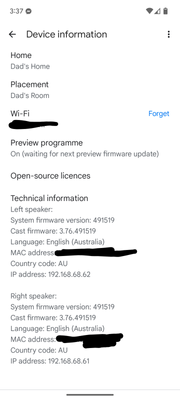

spoco2
 here's the details of the speakers, I can't get to the Chromecast at the moment.
This has been happening before and after full resets.
It doesn't happen during playing music via casting, only when using them as speakers for the Chromecast via Bluetooth.
They're on my bedside tables, both level.

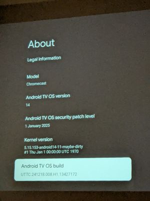

spoco2
 and here's the info of the Chromecast
