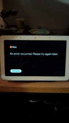

04-29-2025 02:05 PM
Same problem here. Affects Minis and Hub also.

04-29-2025 09:33 PM
As of tonight - all my Google nest minis are working with Youtube music!! Is it working for anyone else? I have done nothing beyond the regular resets/updates a few days ago.
04-29-2025 10:36 PM
Indeed, it started working overnight now. YouTube music has not worked for a week, no matter what I configure.
04-29-2025 11:52 PM
All working here too 🙂
