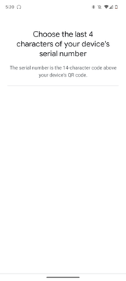

Scanning Qr code doesn't work. Pairing error. I presume everyone else has tried scanning, it doesn't work so are trying to add manually. But the input page has no entry box. Nowhere to input numbers. Just says enter 14 digit key, then doesn't give you anywhere to input it.

I have the exact same problem. It asks for the last four digits in the serial number and then there’s no place to enter it. These cameras are pieces of junk. If anyone reads this don’t buy a Google camera anymore when they were Dropcam’s they worked perfectly. I’ve had them for over 10 years now that it’s gone over to Google it’s terrible and you can’t get any help from customer service. They just ignore you.

01-02-2023 08:21 AM
I have the exact same issue. Added a screenshot.

It’s not a thermostat it’s a camera. Which I indicated at the start of this most painful process. I have entered the set up code. Next the app asks me to choose the last four of the serial number from a list but the correct serial number does not appear.

Regarding your attempt to install your camera, this seems to be your first post in this long thread on thermostat installation, so there does not seem to be anything you've indicated yet in this "most painful process".
You could make sure you're using the appropriate app for the install. If you try to install one of the older Google Nest cameras (those that only get installed in the Google Nest app) in the Google Home app), or if you try to install one of the newer Google Nest cameras (those that only get installed in the Google Home app) in the Google Nest app, you can get the result you're reporting--no serial number listed.
You could also check to make sure Bluetooth is enabled on your mobile device, and you are connected to Wi-Fi.
And if you are re-installing a previously used camera, you could make sure it was previously removed from the Google Nest app or Google Home app (as appropriate), and was successfully factory reset (https://support.google.com/googlenest/answer/9252162).

I just had the same issue and it is time-consuming and painful. My issue was that I was using an O instead of 0 for the code. Instead of an error message, it just sits there and does not display the list.
