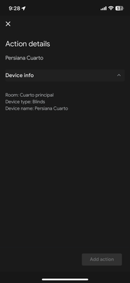

This is how the shades looks like when I selected on a Automation/Routine
It does not show any action to perform:
