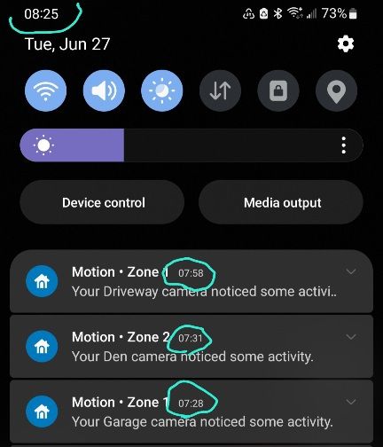

Here's a perfect example that just now happened ... see screenshot
I heard one Nest Notification beep, then two seconds later, I heard a second Nest Notification beep ... so I viewed the Notification list
See the current time in upper left... now look at the times of the original three Nest Notifications in list.
Delayed Notification beeps from Nest app that were from 30 minutes ago to an hour.
