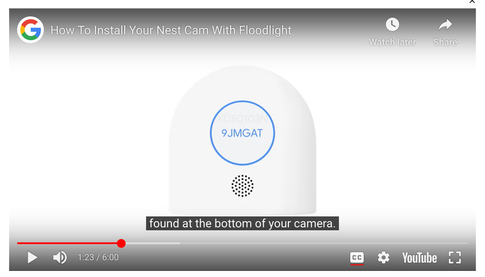

MplsCustomer
@Sarahward75
The QR code was on a sticker on the face of the camera, but you can select "Continue without scanning" and enter the 6-character alphanumeric setup code on the bottom of your camera. You'll have to unscrew the power cable to be able to see it, as the size is exaggerated in the video:
https://support.google.com/googlenest/answer/11003780
