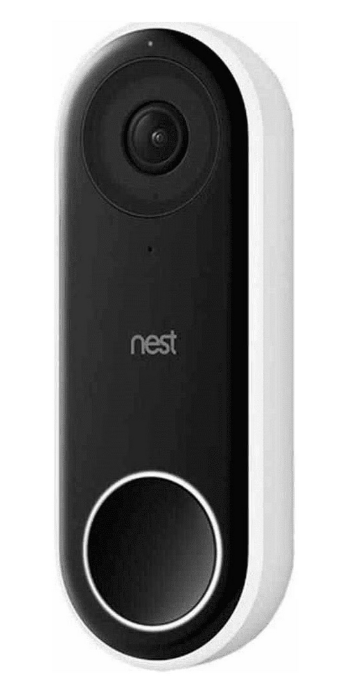

MplsCustomer
@agarcher
Below are photos of the (1st gen) Google Nest Hello Doorbell (it has a black face) and the 2nd gen Google Nest Doorbell (larger, in several colors).
This post has a wiring diagram for the 1st gen Google Nest Hello Doorbell:
https://www.googlenestcommunity.com/t5/Cameras-and-Doorbells/Wiring-diagram/m-p/24455
This post has diagrams for the 2nd gen Google Nest Doorbell:
https://support.google.com/googlenest/answer/12153643
I don't know if your indoor doorbell chime has been damaged. In the post below, Google Nest says "The chime connector allows the chime’s wires to deliver constant power to the Nest Doorbell (wired) and protects your chime from damage."
https://support.google.com/googlenest/answer/9247132
If you are missing a chime connector (aka "chime puck"), you could try contacting Support, using the link and instructions in this post:
https://www.googlenestcommunity.com/t5/Cameras-and-Doorbells/Using-Google-Nest-s-quot-Contact-Us-quo...
(1st gen) Google Nest Hello Doorbell(1st gen) Google Nest Hello Doorbell2nd gen Google Nest Doorbell2nd gen Google Nest Doorbell
