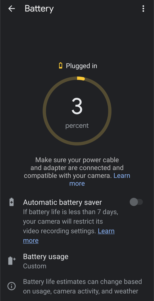

The camera and flood light are hardwired to electrical power and we have confirmed that power is live. When first installed the camera "battery" status - in Google home app on Android - showed the infinity symbol, as the camera is plugged into charging cable from the floodlight assembly, and the floodlight in turn is connected to AC power (confirmed that power is ON in circuit in question).
However, when viewing the camera later that evening, the battery level showed a percentage of 3%; this morning, battery now shows 6%, even though the camera itself has been plugged in, uninterrupted, for 12+ hours.
I would expect to see the "infinity sign" in battery status, as originally showed upon first installation.

See attached images showing the (hopefully incorrect) battery level - again, this unit (camera & floodlight) have been connected to AC power (verified ON/live) for 12+ hours.
Last night
This morning

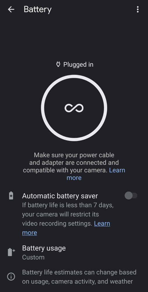

Update 2: then quite inexplicably, this morning, suddenly the camera was back in action with the "battery status" displaying as it had originally, upon first setup, as "plugged in" - absolutely NO changes to the environment nor to power to the camera+floodlight 😳 😕
