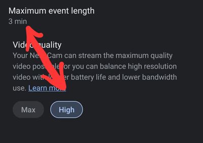

Today I installed the optional hardwire wall outlet plug. Works without any issues. However, in the settings menu for Video. Every time I choose 3min long clips and back out of the menu. It switches right back to 1min clips. Anyone know what the problem is? Is it because I do not have a subscription? I would like to know because I was thinking about subscribing, but if this is a problem. I might start looking for a new doorbell.

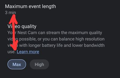

In the labels section. I selected Android.. so, yeah. I use Android. Next I am up to date. I am a computer tech and troubleshooted it down to the app being the issue. If I select Video and change quality to High it will select 3min. Then when I hit Max for quality it will show 3min but as soon as I close the app and reopen it will switch back to 1min.

I did remove the app and reinstalled Google Home. Video by default was set to 3min clips on Max. So far, it looks like it's holding, but I won't know for sure until it actually records a 3min clip. Thanks for the help
