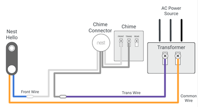

  • Also, make sure the Nest Wired Doorbell circuit is complete. Here is a picture of the diagram installation:

The wiring diagram is nothing like what we have here the transformer is integrated into the chime.
This means A/C in 2 cables out put to doorbell 2 cables that's it,  the chime connector on the one I have  only has 2 wires.
