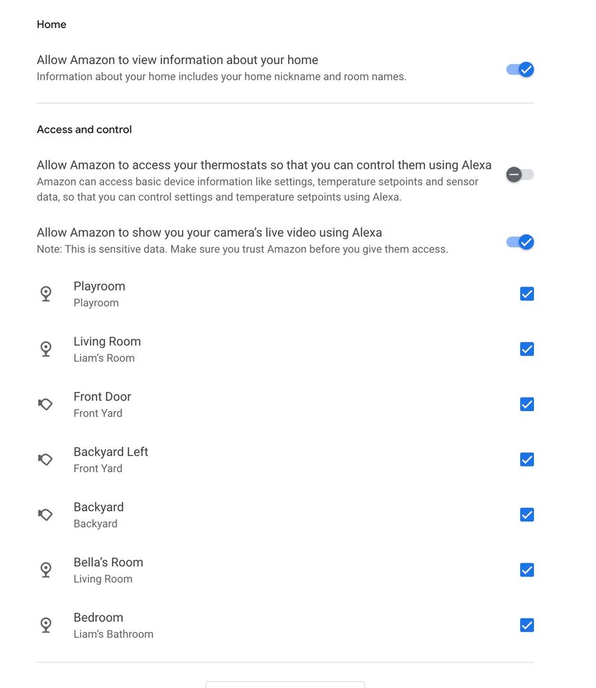

I am supposed to be able to send notification events from my Nest cameras to Alexa via the Partner Connections Manager like so:
https://support.google.com/googlenest/answer/9325080?hl=en#CamDoorbellAnnounce
When I log into my Partner Connections Manager labeled : "Amazon’s access to your Google Nest devices", I see a section for "Home" and a section for "Access Control", but I do NOT see a section for "Events". There is simply no section for it. Google Home has been replaced by the Nest app, so I'm curious if this option was removed once they made the switch.
Anyone else able to get this to work?
05-17-2023 06:18 PM
Example of what I see
06-21-2023 03:07 PM
Hi JosiahE,
Thanks for posting — let's get this sorted out. What type of Nest cameras do you have? Do you have an iOS or Android device?
As a reminder, Alexa motion and person announcements are only supported on Nest Cam (battery), Nest Doorbell (battery), Nest Doorbell (wired, 2nd gen), Nest Cam (indoor, wired), and Nest Cam with floodlight. Person announcements are available in the US only.

06-27-2023 05:57 PM
Thank you both for following up! The issue appears to be that I have 1st generation cameras. I just purchased 2nd generation cameras, so we will see how things go!
