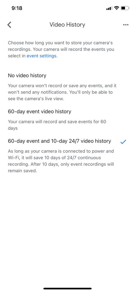

12-11-2022 08:38 PM - edited 12-11-2022 09:00 PM
Ive tried searching the option on the Google home app and i did not see this "60-day event video history" option anywhere.
Could you please provide a more detailed guide as to where I can make this change? Its frustrating as once I plug it in, the solar panels prevent it from from going in to idle mode.
Heres a screenshot showing what is available:
12-12-2022 07:24 AM - edited 12-12-2022 07:25 AM
I think your screenshot may have answered your own question. Your screenshot says your camera is NOT recording 24/7. Your screen shot indicates that, BECAUSE your battery camera is plugged into a solar panel, it is not and cannot record 24/7 (and is therefore not going to drain your battery), and instead is limited to recording events that occurred in the most recent 3 hours.
Since we don't have ours plugged into solar power, I can't speak to what you say about it being prevented from going into idle mode. Perhaps, when connected to solar power, the camera goes into "Live" mode whenever you select it, unlike when it is battery-only.
The option I referenced (see below) is available on our camera because our camera is plugged into household current.
When plugged into household current
12-13-2022 10:53 AM - edited 12-13-2022 10:59 AM
