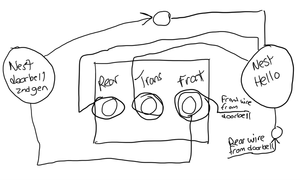

@MplsCustomerThanks for the reply. I did see, after I had posted, a post asking the same thing I did. They did refer to contacting a Nest Pro. This seems like something that should be supported. Both products are Nest. Seems like something that wouldn't be entirely uncommon either. Better to give good information as to how to safely wire the product.
I did try to hash out a diagram I think will work. I have not tried it yet. Here it is: https://ibb.co/7rHckQR
In the example I have my Nest Hello hooked to the rear bell and my 2nd gen Nest doorbell (wired) hooked to the front bell. I'm missing the diagram showing in from transformer but that just stays hooked up to the "Trans" in the diagram.
Does this make sense?

I'm not following your diagram (below); I don't understand the 1st and 2nd gen chime connectors in the diagram. Your 1st and 2nd gen doorbells should NOT share a chime connector.
I think (but am not certain) that you'd wire your Nest Hello with its 1st gen 4-wire chime connector as shown in the diagram for 1 Nest Hello and 1 Chime in this post:
https://www.googlenestcommunity.com/t5/Cameras-and-Doorbells/Wiring-diagram/m-p/24455
And then you'd wire your 2nd gen Google Nest Doorbell with its 2nd gen 2-wire chime connector as shown in the diagram for 1 doorbell, 1 transformer, and 1 chime connector on this Help page:
https://support.google.com/googlenest/answer/12153643

@MplsCustomerI'm going based on the diagram from https://www.googlenestcommunity.com/t5/Cameras-and-Doorbells/I-would-like-to-add-an-additional-nest-... . The two Nest Hellos share a connection there.
I currently have it setup based on the article you linked at https://support.google.com/googlenest/answer/12153643 . Specifically the one with "One Nest doorbell, one standard doorbell, one chime". I just want to add the Nest Hello instead of the standard doorbell chime.
I'm not an electrician but the way I think about it is that joining the Nest Hello and Nest doorbell 2nd gen (wired) chime connectors together makes it share the Transformer power from the Nest Hello chime connector. At least that's my thought.
10-17-2023 09:27 AM - edited 10-17-2023 09:30 AM
I just don't know, since the 1st and 2nd gen chime connectors are different, and are wired differently.
It's unfortunate Google Nest won't provide a wiring diagram, since they know the chime's specs and we do not.

I worked on this tonight. Used the following diagram from my electrician friend.
Everything is working just fine. 2 minor issues along the way. Had to move my Nest Connect closer for setup, but it’s working fine when I moved it back to where I had it. Also the indoor chime defaulted to off so I thought something was wrong with the wiring, but I changed it in the app and it was fine.
Basically if you ignore the 2nd gen doorbell and just keep those wires in place and just wire it up according to just having one Nest Hello then it should work.
