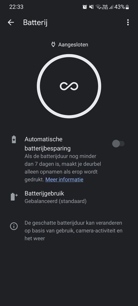

I bought a google doorbell and waired using a 12VA transformator. I cheked doorbell voltage and it resieve 12V but in google home app it does not always shows the waired connection, it switches to battery automaticly and it turn the device off when it is 0% and than automaticly charge the doorbell. see pic

Hi,
It's a google nest doorbell battery but i can be wired(i used wired option), there was no power outgae, i can view camara feed somtime, it light green when it see people but it hast charge no light.
