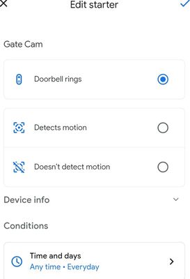

Thanks for replying.  However I disagree:
When creating Automation rules, it is possible to configure the doorbell press to act as a Starter for activating other smart devices - it is specifically referred to a "Doorbell rings" in the menu (see attached screenshot).   But it doesn't work. Surely then it is a bug, not a feature request?
