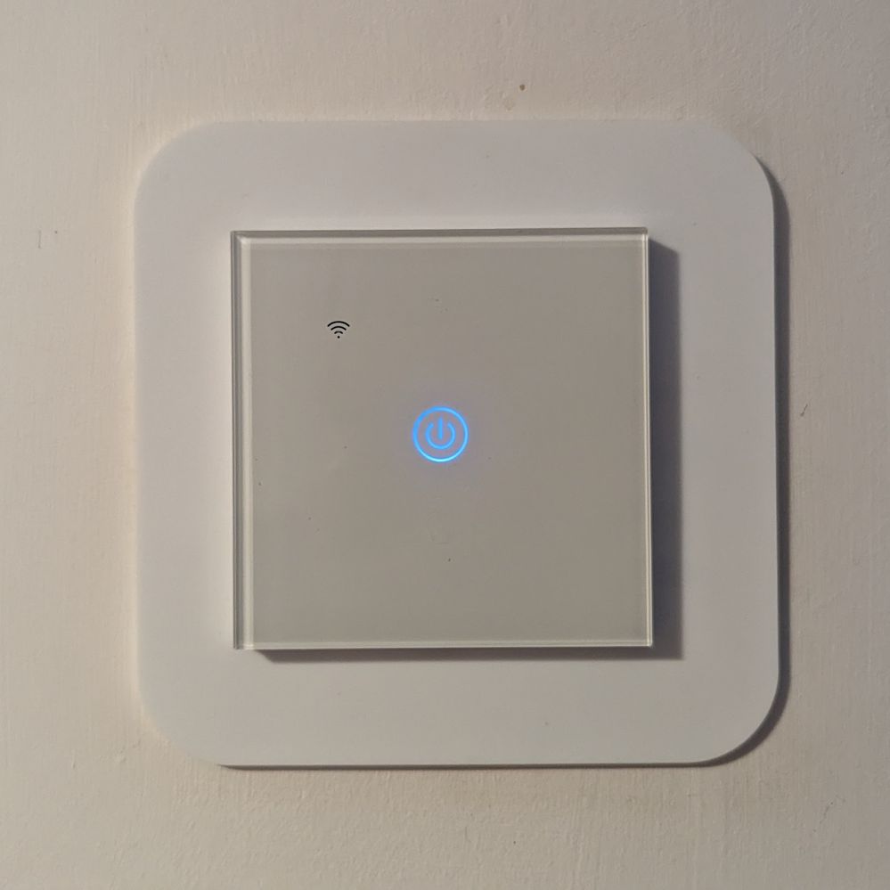

Up until the last few weeks I have had an automation, that basically turns on some LED lighting strip (Tapo) under my kitchen cupboard when the physical kitchen main light button (Smart Life) is physically pressed (not a button in the smartlife or home app, but actually pressing with my finger) . This uses the change in status of the Smart Life device to turn on the LED strip on and off, basically so the LED lighting works in tandem with the main ceiling lights without the need to electrically cross wire the devices or issue an audio command to google home, it just works by anyone turning the kitchen light switch on, this has worked since Google introduced their ability to trigger automations with device status changes.
I now see that the devices in either SmartLife or EnerjSmart (same company) cannot now be used to trigger automation events. They aren't even selectable as a trigger option.
Has the ability to trigger automations by physical devices now been removed ? It seems you can use Displays, Lights, Outlets, Speakers and Thermostats to change the status, but not Switches.
I've tried re-linking removing and re-adding and all the normal stuff you do to get google home working again, but this looks like something Google have enforced at the back end.picture.jpg

When I look at the switch in google or tuya, there are three switches for one switch. Don’t ask me why. You have switch one, switch two and an other switch. You have to find out what switch you have to use in your automation. I guess that’s your problem.

For the first message see the picture.
