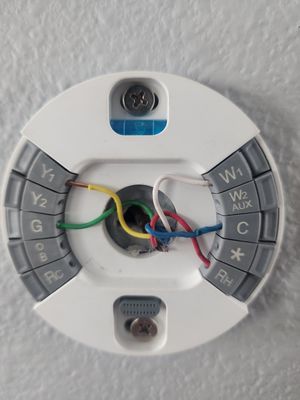

Long Story: I bought a new house about 2 years ago and have been running into some HVAC issues. Its an AC with Gas Furnace that includes a Whole house Humidifier. For whatever reason the Furnace will randomly kick on with the AC. It tends to be during dusk when the outside cools off but the house can be hot. Or like today. Low 60s and sunny and the AC kicked on because my sons room got to 73. Screen goes blue an everything. We originally thought it was the WHH because he WHH came with a smart humidistat so we removed the "Smart" and replaced it with an old models that just adjusts with humidity but should can kick on the fan. Still happened. So I completely disconnected the WHH. Still happened. Had 2 different companies come out and check and everything seems to be on the up and up. Then today it happened again. The only thing I can think is the Nest Controller but unfortunately its out of warranty.

I did notice that the "Heat Source" is set to Electric but its a gas furnace.

Based on the picture, your wiring configuration seems to be good. However, since you’ve already contacted your HVAC technician to check your system and the issue persists, the team would like to learn more about this behavior. When you get a chance, please fill out this form and let us know when you’re finished. We’ll have someone reach out to you via email from there. Please make sure to add the link of this thread and your community username.
