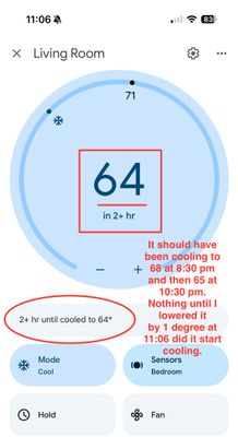

And nope. The schedule switches, but it doesn’t start cooling.
It’s 11 pm and should have started cooling to 68 at 8:30 pm, and should have switched again to further cool to 65 since 10:30 pm. Two and a half hours, and nothing. It didn’t start cooling until I manually lowered the temp by one degree to 64 at 11:06 pm. And only “then” does it says cooling “2+ hr until cooled to 64” and actually start cooling our house.
