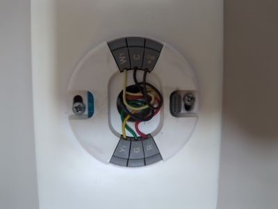

Was it working before, or is this a new install?
Post a picture of the original thermostat's wiring if you have it

It is not wiring as it runs AC only, on ECO
Have hard reset and rebooted couple times
When turn to Cooling, it starts the AC fine, but turns on the furnace after several minutes

@LakeshoreEast
Well, I can't help you if I can't see what's going on.
