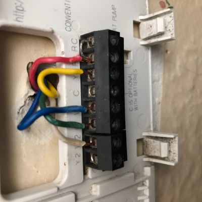

Hello, my new HVAC man recommended a nest ‘learning’ thermostat w/ sensors. (Sexy).
my current thermostat is an outdated Honeywell that runs on 2 batteries.
His partner went to install the Learning thermostat, and said it can’t be installed without a C wire. (makes sense).
Currently, I have 5 wires (which appear to be) labeled as:
W2, G, W, Y2, R.
I took a pic.
The (awesome) nest app provided a ‘diagram’ of where I can attach my current wires to the nest thermostat!
how exciting,
Except… my HVAC man said the nest doesn’t run on batteries and still can’t work without a C wire.
So haven’t tried installing it yet.
 Can anyone confirm this won’t work?
or explain it to me?
 I understand I have no electricity to run a thermostat without C-wire,
but then I noticed the box of nest thermostat stating it doesn’t need a c wire? And works with 95% of homes.
second concern,
He said he “can add a C wire”
however, I’m concerned. Before I do this, is there a way to double check this will guarantee the nest learning thermostat will work for my home?
(I’m becoming tired of the “should have” and failures.. 😞 and past hvac cover ups by prior crew and more money being wasted)
Is this thermostat actually compatible?

I am not an HVAC expert. (I hope an expert will reply to you.) But I installed 2 Nests in my home on 2 existing heat pumps. Both had a 'C' wire. The 5 ton unit worked fine with the 'C' wire hooked to its Nest, but the 2 ton unit refused work properly until I DETACHED the 'C' wire. After searching the Internet, I found others reported the same, but very rare condition. I think you can safely hook up the Nest as it guides you, trying the existing wiring, and test for functionality.
Peter, the other end of the C wire must have been mis-wired.   Usually the 24AC (R) and it's common (C) come directly from a 120VAC to 24AC transformer.  Bringing R and C from the transform will work (unless the transformer is bad/overloaded).
Charles333
Certainly a common is preferred.  I would start by giving the current bundle  at your thermostat a good tug.  There is a chance there are more unused wires.
If not, it is true there is a fair chance it would be alright without one.   Got a voltmeter?   Measure the AC voltage between R and the other wires.   You may well be getting a good enough ground return via the other wires.   I think 24AC can be quite forgiving.
Your wires used are weird.   Y2?   That implies Heat Pump.  But no O/B? - not good.
Do you have a Heat Pump?
What kind up main heating?  One or two stage?
You really need to find where the wire bundle is going.  It will be near furnace/air handler.   That will tell all.
You most likely do not have a heat pump and the Y2 is for your air conditioner.
And yes, the Nest will be compatible once you get the C line sorted out.

The new HVAC man said we have a two speed heat pump.
I was confused about the wires myself…
Kim6
Yes, 2 stage heat pump!
Im concerned about the wires..
The Honeywell thermostat was installed November 2021… by a prior hvac man (totally screwed us every way). He said it was new, he likely got it from a past job because it was filthy. He was supposed to do everthing, including the wiring, but I suppose he got lazy. (We had to replace all the ductwork he did as well by a different crew). Paid him for premium services and parts and got the lowest quality crap. I’m not surprised this was his cheap solution.
