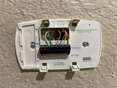

Just bought a gen 3 nest thermostat and I set it to cool and only hot air blows out. I have two ac units I’m not sure where I went wrong any help would be appreciated.
You have your new Nest wired wrong.
Try this,
White - AUX to W2/AUX
Green - G to G
Orange - O/B to OB
Blue - C to C
Yellow - Y to Y1 <-Edited
Red - Rc to Rc (jumper to R not needed) <- Edited
Be sure to do a reset to factory defaults so you clear everything from the thermostat.

Teo5
Try this,
Green - G to G
Orange - O/B to OB
Blue - C to C
What about the red wire
I messed up, sorry about that. I corrected my original post,

We always have one goal, to be as helpful as possible. We could try the wiring configurations suggested by Patrick_Caezza and let us know how it goes by replying to this thread. The red wire should be connected to Rc as it is the power source for your thermostat to share from the HVAC.
Ryan
Yeah this worked this was the fix I appreciate your help.
Thank You

This worked perfectly for us.  We were having the same problem - the A/C was blowing hot air.  Our old thermostat had the orange wire in W1 so that's where we put it.  When we moved it to O/B as suggested, cool air started blowing.  Thanks for the solution Patrick!

Mine has done the same thing brand new best thermostat. It won’t cool as soon as the old thermostat is put on it works. I believe the nest thermostat is the issue. Return it!!! Get your money back
Teo5
I put my old one back on and everything works fine not sure what it is? I like the looks of the new one but if I can’t make it work I’ll have to make due with the old one.
