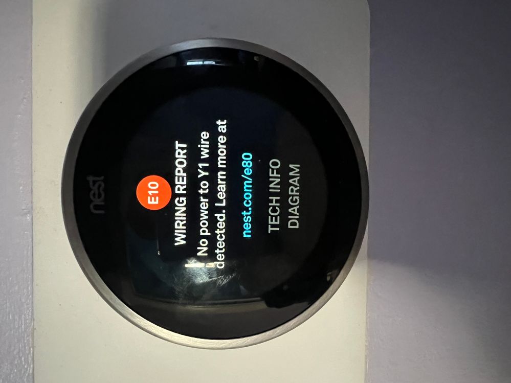

I plug the unit into a USB adaptor and charge it until 100% and then reattach it to the wall. Once on the wall the battery drains itself and it is dead by the morning. I used to have the yellow Y1 wire connected but disconnected it b/c the a/c is no longer working. I thought that might be the issue. Current setupCurrent setup

We have had the Nest for a while and it worked without issue without the blue wire connected. The a/c no longer works and an animal may have chewed through the wire. When I remove the Y1 wire we can use the heat and it will hold a charge overnight but by morning the battery is dead again.

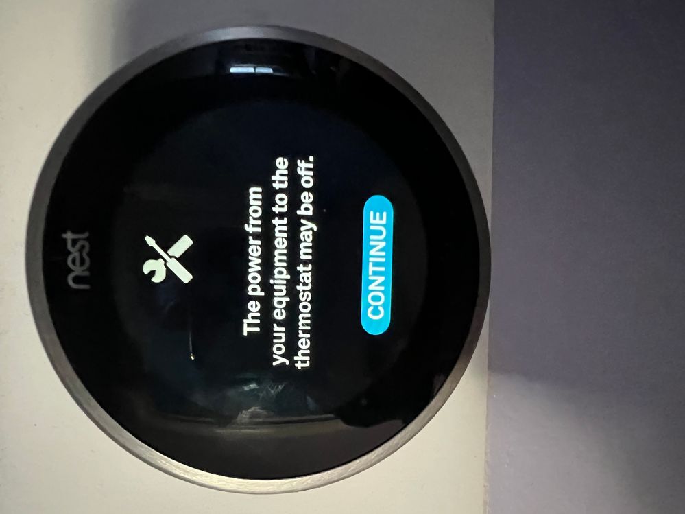

I have attached new pics with what is displayed on the Nest.IMG_1001.jpegIMG_0999.jpegIMG_0998.jpeg

Thanks for reaching out. I understand that your Google Nest Learning Thermostat 3rd generation is showing the E80 error code. I know that can be frustrating. No worries, I'm here to help!
As you mentioned that the A/C is no longer working and you disconnected the Y wire, I recommend performing a factory reset to change the  configurations at only heating to do this  Go to Settings > Restart > Factory Reset.
After performing the factory reset, you'll need to set up your Nest Learning Thermostat 3rd generation again. When your device asks for your system, select that you have a fan and heating system and if you have single or dual fuel.
