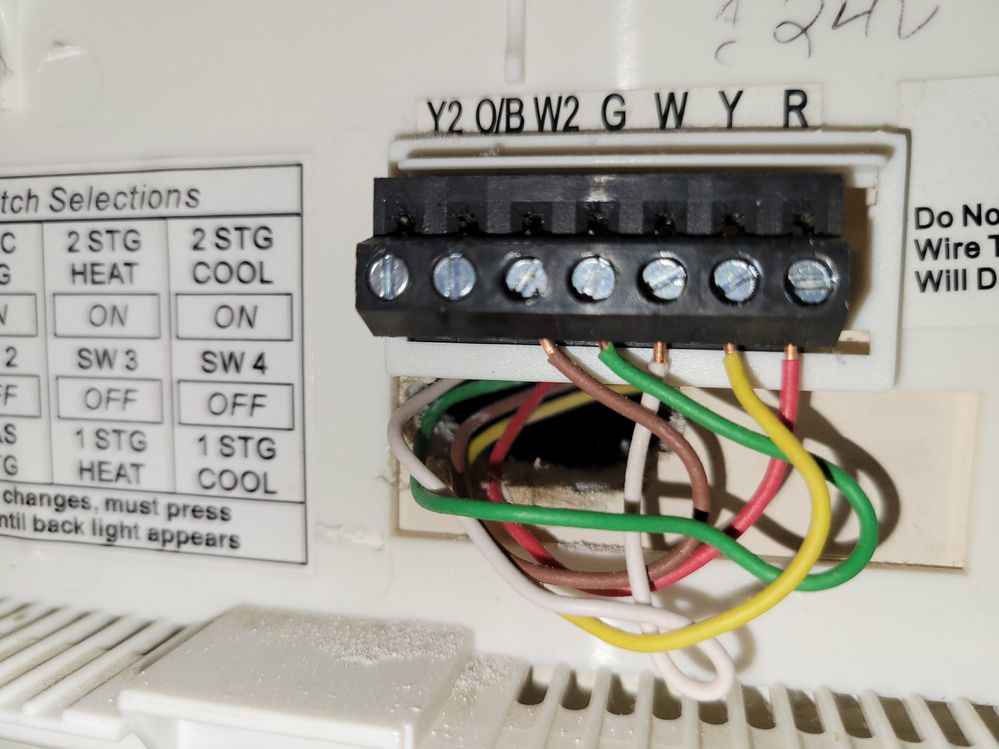

12-17-2022 08:09 PM - edited 12-17-2022 08:11 PM
I think I did this right. Also, the compatibility checker gives an ambiguous answer. Too expensive a product to go with a maybe.
Wiring
12-27-2022 12:43 PM
Hello there,
Thanks for assisting, Mel.
@Mad_Lad, Thanks for posting a picture with your thermostat wiring diagram. It appears that you have a compatible system with the Nest Thermostats. Please note that if you're planning to have the 2020 version of the Nest Thermostat, a C wire or a Nest Power Connector is required to deliver constant power to the thermostat.

I think my question was answered. I can buy a Nest thermostat (minus the 2020 version) and not need a C wire. Not sure if my system has one even though the wiring doesn't show one.
