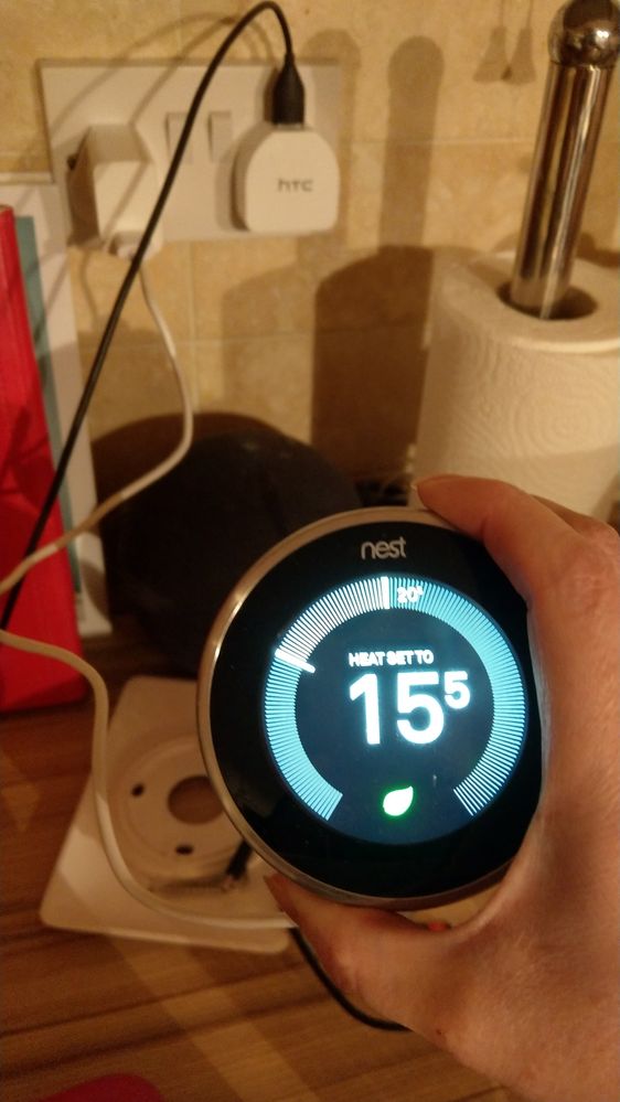

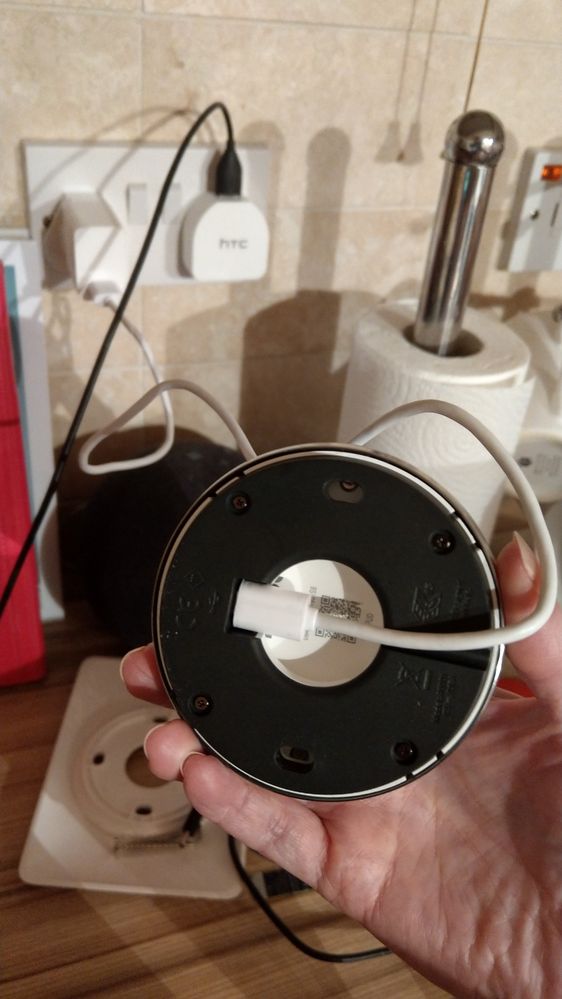

The base plate on the back of the thermostat in my handThe base plate on the back of the thermostat in my handWhere my thermostat currently isWhere my thermostat currently isPlace where the thermostat wasPlace where the thermostat wasPower infoPower infoThe original error message, which was the same error message after the Boxt engineer left as before he replaced the receiverThe original error message, which was the same error message after the Boxt engineer left as before he replaced the receiver

Thanks for the photos, @Lennia .
I see that you connected a USB cable directly into the base and it's charging. It also shows 5 volts at VUSB which is what we want to see while it's powered by USB. This means that there's no issue with the base. You can use the USB cable instead of the T1 and T2 wires from the Heat Link. Does your thermostat power off while it's charging via USB?

My case number is 8-0250000032235. I'm not able to give power readings whilst the thermostat is on its base because the base had to be removed from the wall and attached to the thermostat before the thermostat would work. I also don't ever remove it from the phone charger because I am too scared that this will stop it working and I will again have no heating, so it's just permanently plugged into my phone charger and I've had to get another one. Luckily it doesn't power off whilst it is connected to the USB cable, it functions as it used to when it was on the wall up until the failure on 5 April. Whatever the Boxt engineer did, did not resolve the issue and I still had the Heatlink error message after his visit. The voltage at the terminals was measured as zero with a device my engineer used, but when the base plate was removed, the voltage from the wires from the wall was present and was whatever it is supposed to be - I know because I was concerned that perhaps the wire in the wall had blown, so I specifically asked him to check that and it was fine. So basically there was live power from the wall to the base unit, but no power going through the base unit to the thermostat. However, to get the thermostat to accept that it was part of a functioning system and communicate with the receiver on my phone charger, the round base plate part that plugs into the back of the thermostat had to also be removed from the wall and is also in the kitchen. It is not a viable solution long term however, as it registers temperature fluctuations from the hob and kettle, and the kitchen is a colder room, so the rest of the house gets too hot. I want it to be installed back on the wall, but as I said, the power is not getting from the mains power to the terminals.
